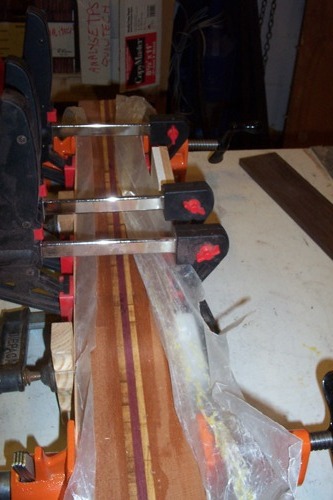

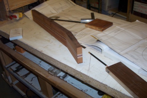

Made a laminated board with Mahog', purple heart and 2 strips of some white wood i recycled, not sure if it's maple or whatever, nice grain in it tho!

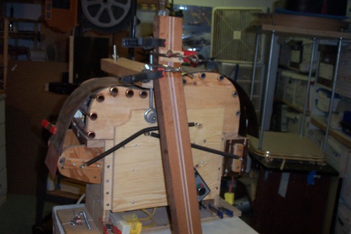

That was last week, just before i left to see the in laws, i had cleaned the shop just before i left so here's a rare shot of my shop in order!
Since i got back, i cut the 15 degree angle and glued it, what a PITB to get those 2 pieces together without moving!

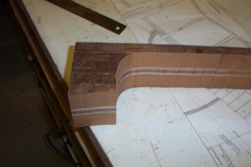

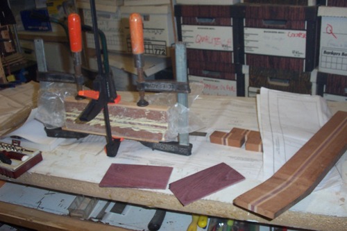

Then i used my drum sander to bring the headstock to thickness and made another lamination of the same stuff that i will cut in 3 sections of 4" long to build the stacked heel, the 2 veneers are purple heart that i sanded to help me see what it would look like on the headstock, i'm not decided yet if it's gonna go on there tho. I might just go with EIR as Anthony and Steve had suggested.

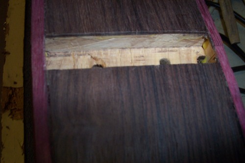

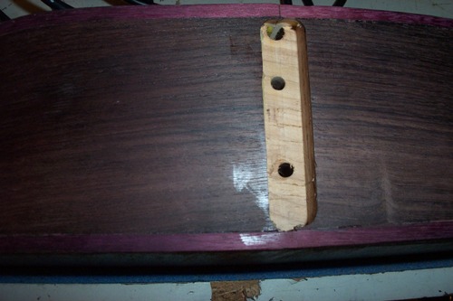

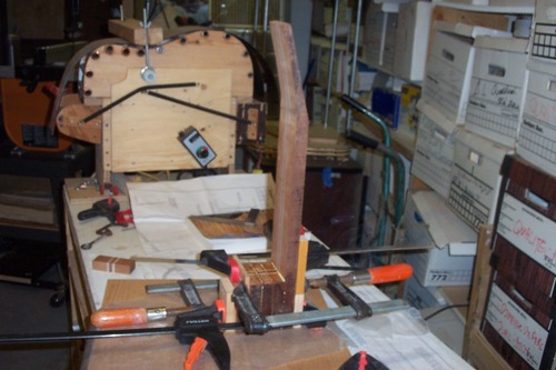

While the lamination was glueing, i thought i'd route out the EIR that covered my neck block in my soundbox
Finally, the stacked heel being glued

Thanks Russell, and it lines up pretty well too as you'll see here but if i were to do it again, i'd use a bigger chunk of mahog and other woods to make 2 neck blanks, i would have saved myself a lot of trouble with measuring, thicknessing, glueing and cutting But i learned a lot!
